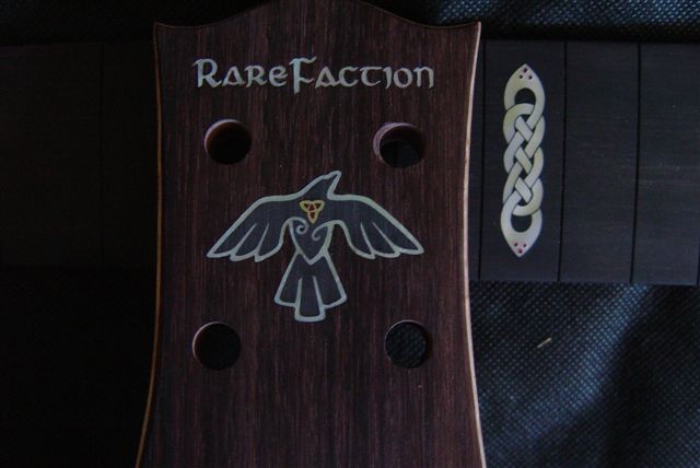

Here's an inlay done a while ago. No engraving, just saw cuts!
Some day soon I'll buy a magnifying glass
Thanks for looking.
Paul

Oh wow!!!!! STUNNING!!!
Materials? Mother-of-pearl...is that ruby in the knot?
I have GOT to make a second guitar, you've given me ideas...
Your work is beautiful and very inspiring. Thank you for sharing it!
Sam Price38950.1190625

Thanks for posting, Paul. I'm really impressed by those itty-bitty, delicate cuts on the letters! Clean!
PostPosted: Sun Aug 20, 2006 1:38 pm
ME TOO. What size blade do you use?

Sam- It's actually Agoya, with a gold MOP knot, filled with a special secret engraving filler. Some in the forbidden inlay lairs call it "Crayola Red".
(Anyone know Stew macs phone #?)
"Okay, I stinkin' QUIT inlaying! " Larry, I say that all the time!!!!!
Steve- I used a 3/0 blade for this one. I tried a 6/0 but broke too many blades, and figured I might damage the inlay.

Very good looking work Paul!. One quick question, when doing the knot, is the cavity routed through the whole shape? I mean, is it filled in with epoxy and dust, or as I suspect, each piece individualy routed with the "islands" of the wood left within the loops of the knot?

In this case, some islands are at the bass and treble sides,and inside the larger openings.
I've wasted a lot of time trying to route every minute island only to have it disappear when just "kissing" the side. Obviously, ebony is much more forgiving on this.
This knot was cut in very specific spots, out of one piece.
In order to keep the lay out and line space correct, I tinted some CA black and glued the lines together after cutting. Then the shell was pierced in an area with a small void and the cutting was completed.This results in all sections remaining in their proper orientation.
Fill in the remainder of the lines , clean up the "exterior" portions of the knot, and it's ready to inlay.

So Paul what do you use as blade lubricant?

I used to use the lube sold by Rio Grande, but seldom use anything today. It seems like I can feel the blade better without it. (I typically chase a cut with a needle file to get rid of the serrated edge left by the blade).
I go through a lot of blades, and many of you know ,on average, 3-4 out of a dozen are defective. Not very good odds when you're cutting delicate parts!
